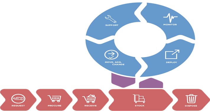

From a technology standpoint, you could do this from either direction, but when it comes to asset related processes, it is best done from the Asset record, but as you state, that does not always make sense. Let me elaborate with a visual of the lifecycle:
The red portion of this diagram represents the Asset portion of the lifecycle. When you are making any changes in that portion of the lifecycle, it makes sense that those State changes are initiated against the Asset record. This includes moving from In stock to In use and even back into stock when a device is decommissioned.
The blue represents the operational aspects of the lifecycle. For state changes where something remains In use from the asset perspective, it certainly makes more sense to just be updating the Status of the CI and not even touch the Asset state if you do not need to. An exception might be if you transition something back to a "stockroom" for repair or maintenance.
All this being said, if you get your processes set up properly, you do not end up touching the State/Status of the Asset or CI unless it is from an exception standpoint. Then the updates become driven by the workflow. Then you end up tracking the process instead of managing states.
