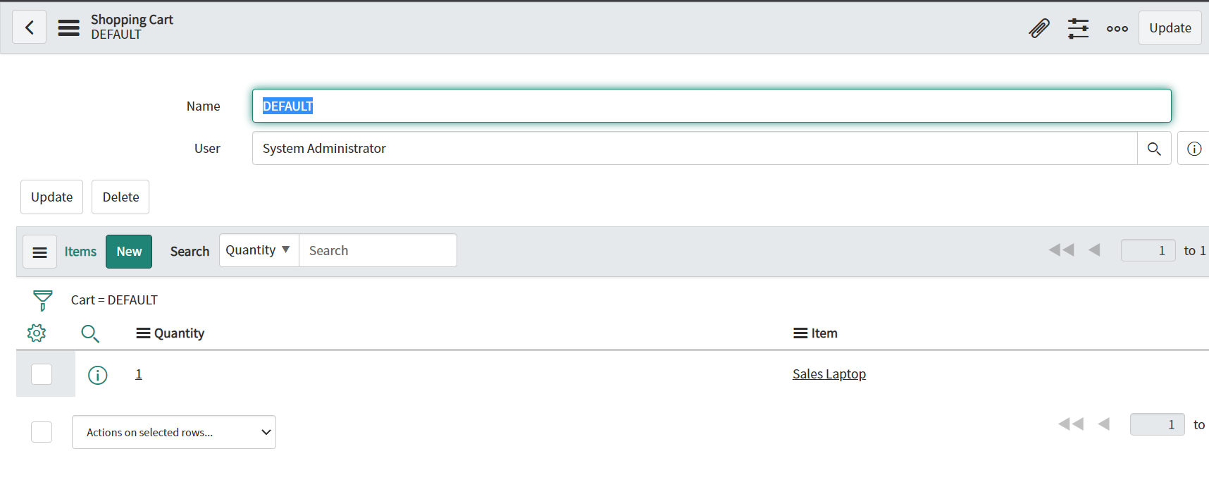

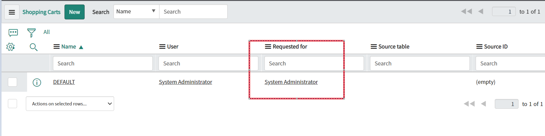

01-23-2022 09:21 AM
Thanks for checking on the above points. Please try below which can be a issue which is causing this:
1) Navigate to Shopping cart table by typing "sc_cart.LIST" in Application Navigator search menu as shown below and hit Enter on keyboard:
Now within this table check if there are any entry for the random user which is getting set for your catalog item in Requested for Field in this table as shown below:
Delete this record and then try again, this may be the culprit here in your case.
Also you can open this cart record which will confirm you for which Item this record was created. Please refer to screenshot below which also shown the item name to which it is linked:
Shloke

We do not actually use Shopping Carts in our environment and have a simple 1:1 relationship with each REQ/RITM. But to ensure this was not the culprit, I did review the sc_cart.LIST records where the Requested For was me and that other random user that showed up for the one request. For both of our DEFAULT records, there are no items listed or linked.
