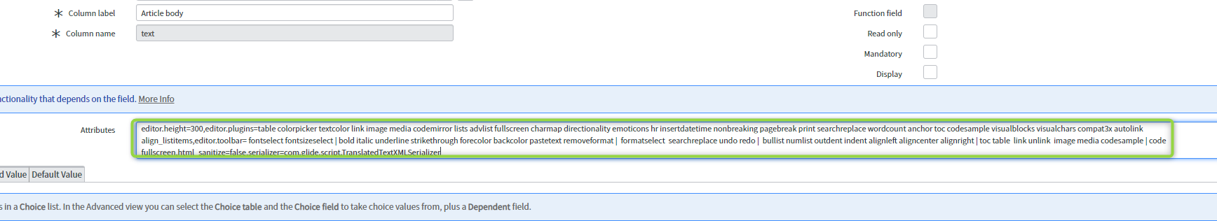

Carl-Johan
At least I found a workaround which is working.
If you go to the Knowledge Article form and choose Configure Dictionary for the HTML field
Then choose the Advanced View, so you are able to see the Attributes field
If you remove the content of the Attributes field - or at least remove the toolbar settings in the field, it seems that it is using the default settings from the system properties instead - and then the anchor icon will be visible.
