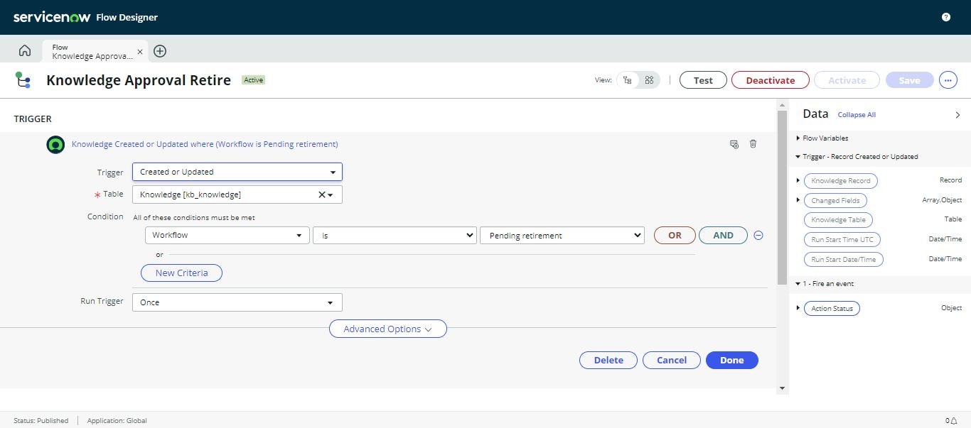

instead of BR you could have used flow designer where you dont need to code, your flow will trigger when records is created or update on knowledge table with condition Pending retirement and then use
Send Notification/Send Email Action to send Notification

Hi @Nivedha G you dont need event in flow designer you could use action.
Here is the document on that. You can use either one
1. Send Notification
2. Send Email Action
