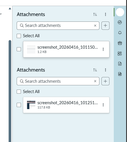

Have you tried adding the table prop value first?
Tried this and it works just by editing table first. You can't bind multiple records in one component though if that's what you were going to do. But you can add multiple of course, it's not too bad looking like that. Shame we don't have much control over the visual aspects of the component.
