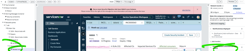

As for your alternative solution, there is an event dispatched from the related records component called Related record reference cell link click.
The form controller has handlers for opening the preview and downloading whichever you think should happen that can be used to handle the event. This works nicely but I don't really understand where the handler that opens the preview page is so I couldn't get rid of the preview opening in the background. If you figure that out I'd be interested in knowing as well
