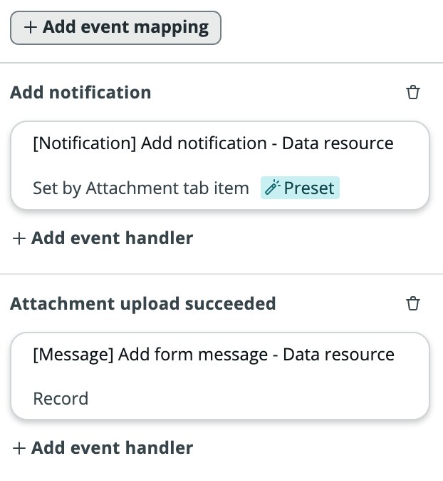

shazaharoun
Hi  mochildbel2,
I'd like to know the anser to either of the two options as we need to add more than just a comment.
If you are only after a comment then in UI Builder you can add an event handler to the present event, second handler in the image.
