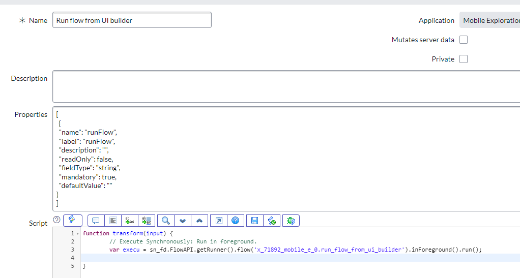

You can trigger flow from UIB using server script.
1. Create a transform and add server scriplet of the flow like below.
2. Add ACL for execute
3. Add this transform to the page
4. Add to the button event. Now, this should trigger the flow when the button is clicked.
