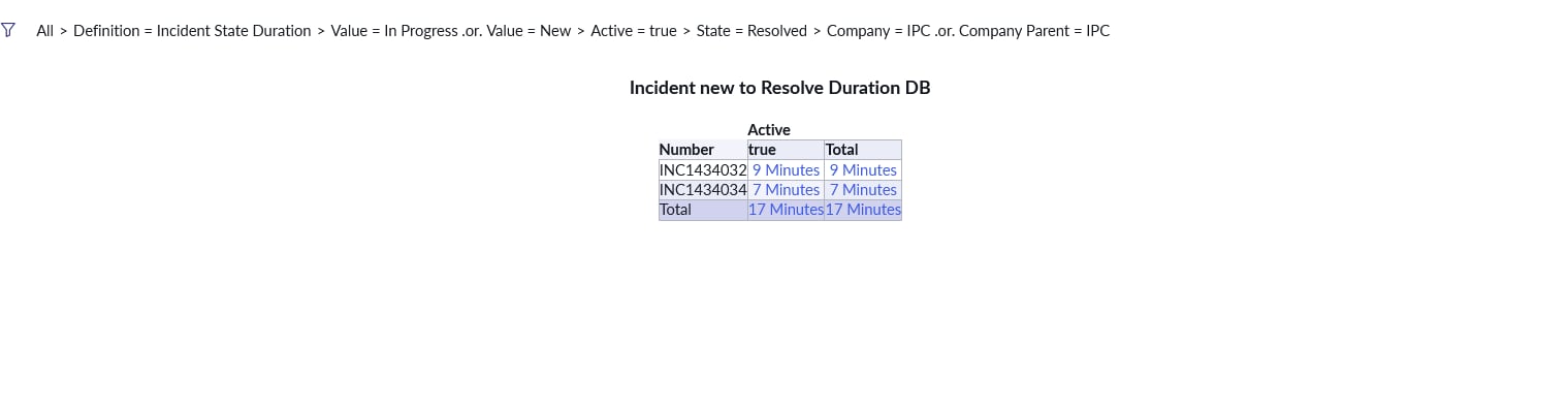

I have developed a pivot report in ServiceNow that calculates the total duration taken for an incident to move from New → Resolved, excluding the time when the incident was in the On Hold state.
Currently, the duration is displayed only in minutes (e.g., "1 minute", "5 minutes"), which appears to be the default behavior for duration fields in reports.

Hi Nischith,
Yeah, this is a known limitation with reporting on duration fields.
In ServiceNow, pivot reports always render duration values using the platform’s default display format, which is typically rounded to minutes (like “5 minutes”). Even if you use GlideDuration or getNumericValue() in the backend, the report layer controls the final display, so those changes won’t reflect there.
Displaying duration in HH:MM:SS or mm:ss format is not supported out-of-the-box in pivot reports.

Important point
Even though the data is stored down to milliseconds, pivot reports only display duration in their predefined format, and that cannot be overridden via scripting.

Thanks for the suggestion.
However, using a custom field in this case seems to have a couple of limitations:
- The custom field would primarily be a string field, which works well for display purposes, but it cannot be effectively used in a pivot report for aggregation or calculations.
- Additionally, while extracting values from the existing duration field, the seconds component is already omitted (as it returns values like "minutes" or "days"), so even if I populate a custom field, the result would still be inaccurate and would not truly reflect the exact duration.
Because of these constraints, this approach doesn’t fully solve the requirement of getting precise minutes and seconds in the report.
If there’s a way to retain the exact duration (including seconds) and still make it usable within a pivot report, that would be helpful. Also, it would be great if you could share a bit more detail on how to implement this approach effectively.
03-26-2026 04:54 AM
then I doubt this is feasible
