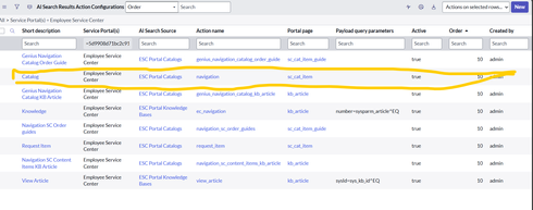

Check Search Result Actions:
  • Navigate to Service Portal > AI Search > Search Result Actions.
  • Filter the list based on the portal you're using.
  • Find the "Catalog" result configuration.
  • Ensure the correct Service Portal, Portal Page, and Action Name are populated.
  • If the URL in the search result is incorrectly pointing to "id=form", it should be "id=sc_cat_item".

This is because of the part in the URL that says "id=form", this should say "id=sc_cat_item". To change this behavior, check the Search Result Action.
Navigate to: Esc Portal > AI Search > Search Results Action. Filter the list based on the portal you are using, then find the 'Catalog' result configuration. On the form, ensure the correct Service Portal, Portal Page, and Action Name are populated.
table name : sp_ai_search_results_action_config
@swapnali ombale I tried but its not working
