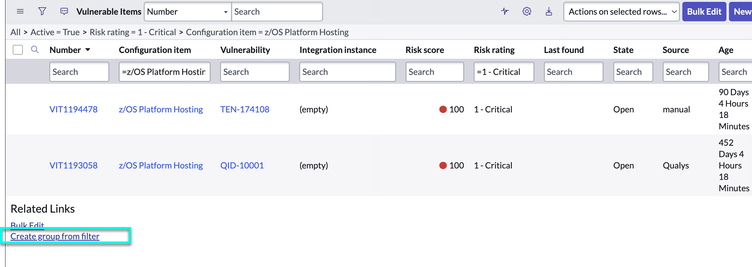

Perhaps check out this hidden nugget...
There is a UI Action called "Create Group from Filter" on the Vulnerable Item table
  - At the moment, I think it is hidden due to the conditions on it baseline
But perhaps something like this would be neat to consider as you solution this:
- The idea used to be, craft your filter query on the list of VITs (based on what they have permissions to see)
- Click the button to create a one-off VUL with those VITs meeting the filter criteria
I know some deployments allow their Remediation Teams to see lists of VITs assigned to them, but not sure if you have opened that up in your deployment...
   --> If you haven't, I recognize this would be a no-go..
Just figured to mention it as an idea to look at, before you head down the path of exposing the New button to the Remediation Teams ...
Reference (After clawing back the permissions / condition on the UI Action)
