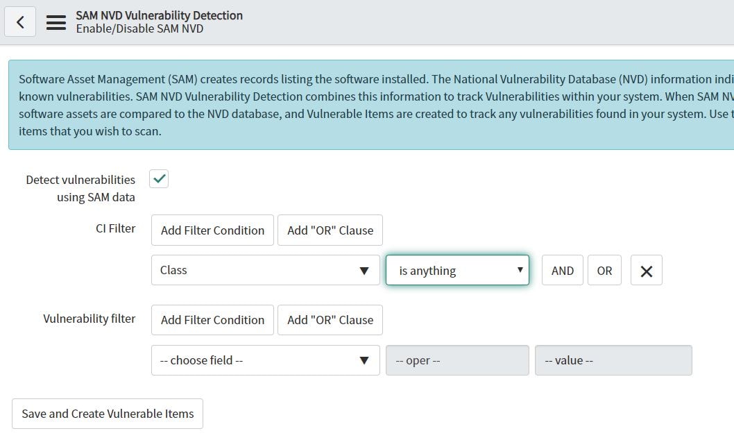

Just to confirm, when you save that configuration - are you seeing Vulnerable Item records created, but perhaps with empty CI values?
Are there records visible in the "Software Installations" module / table?
  • Navigate to [Software Asset -> Discovery -> Software Installations]
Can we try to set a filter to the "Vulnerability filter" on the [SAM NVD Detection Page]?
  • Example: ID | Is anything
    -OR-
  • Example: Vulnerability score | is greater than | 3
On your "CI filter" - I would try out a more aggressive filter on there to ensure that you are actually pulling in valid CIs for your Vulnerable Items
  • Example: CI Class | is | Hardware
Hope you get a win here.
If there are still issues, it might be best to reach out to ServiceNow HI Support.

Software Integrations were created:
I have tried with different filters:
In London version I did get to create them with no problem.... I don't know what I'm doing wrong

There are a couple of things that need to be in place before the VIs can get created automatically such as:
1. Detect Vulnerabilities using SAM data should be enabled before the NVD import or you need to click the "Save and Create vulnerable item button on the SAM NVD Vulnerability Detection form.
Can you please help me understand what you mean by "trying to do manual scan" and "update my VIs through SAM NVD". I can better serve you once I understand what you are trying to achieve.
