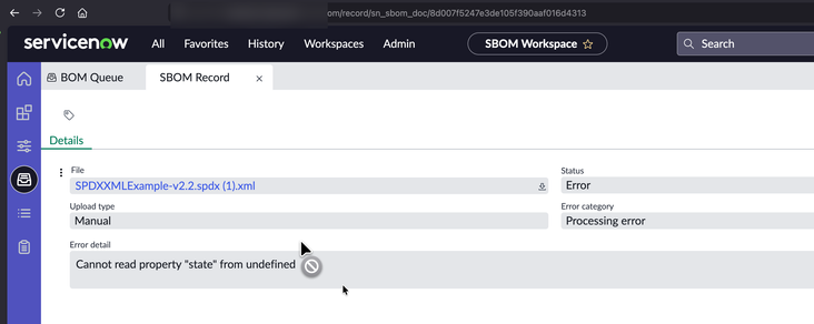

During the SBOM File Uploading in SBOM Workspace "In BOM Queue", getting the below error, can anyone suggest the corresponding steps for troubleshooting it.
Failed to process the SBOM: The undefined value has no properties.
andy_ojha
Hey there,
Not sure if you are able to share the format of the SBOM file you are using, or can test another SBOM file.
I have seen this in my lab as well, and suspect it is due to specific header data of the SBOM file being missing.
Suggest opening a Support Case for this to get to the bottom of the root cause.
Format Field assumed present
CycloneDX (JSON/XML) metadata (and metadata.timestamp)
SPDX (JSON) spdxVersion, creationInfo
