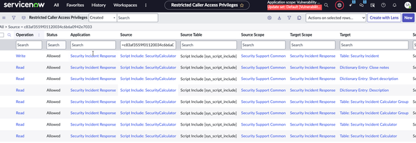

FWIW, I do not see that issue with SIR v14.1.2 (loading the SIR form in Classic UI)
In my instance, the Script Include (SecurityCalculator) is OOB, and I see 8 entries in [sys_restricted_caller_access], for the Source of that Script Include
