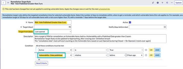

You could also look at using the Vulnerability Published Date in the Remediation Target Rules as well - would just suggest using a more static field to start the clock from on the Vulnerable Item (e.g. Last opened)...
Something like below would be an idea to look at and test with - if you opt to not include Vuln Age (Published) in your Risk scoring:
