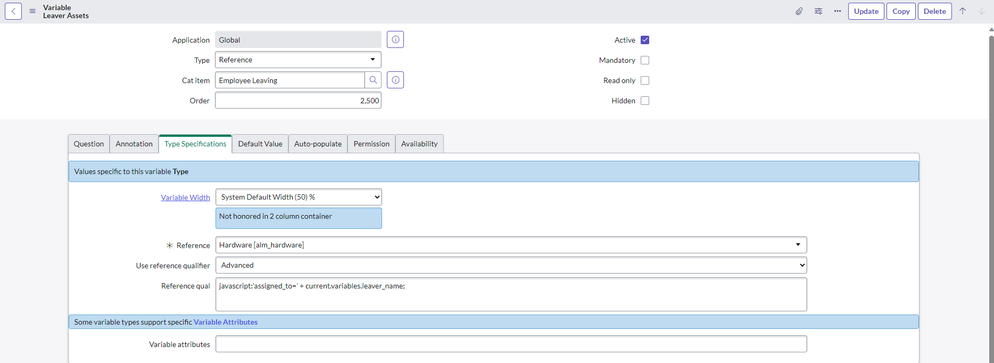

Morning All,
This may be a stupid question, I've tried to search for other methods but I am still stumped.
I have a Leavers form with a variable that displays the assets assigned to the Leaver, with a simple reference qualifier;
javascript:'assigned_to=' + current.variables.leaver_name;
This is working well however I would like to filter it further to only display the assets containing the word "Dell".
How do I go about amending the above script to achieve this?
Jack

Try using below
javascript:'assigned_to=' + current.variables.leaver_name+'^display_nameLIKEdell';

Thank you, that's cracked it straight away
