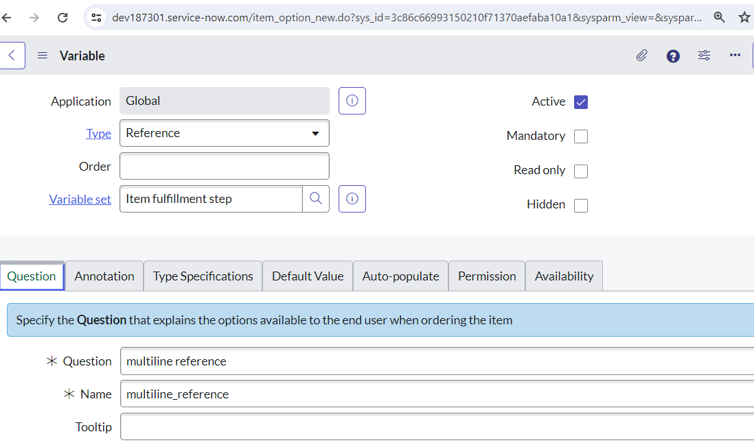

How to give the reference to cmdb_ci_appl table to a multi line variable set so that all the applications present in that are shown in the catalog item.

Hi @Chirag Pathak Do you mean as below?
By doing such on the respective variable in your variable set, all the applications will be listed for selection.
Note: I have also used MRVS and selected in 'variable set' field.
Please mark this as helpful and accept it as a solution if this resolves your query.

04-01-2024 02:37 AM
