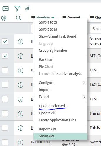

10-19-2021 07:46 AM
Hi Arun,
Is your requirement is to update a list of existing records? then please follow below instructions.
- Open incidents list view select the records that you want to update with check box.
- Right click on column header(list context menu)
- Click on Update selected
- New form will open, then try to update the fields that required.
This will update the all the records you selected.
