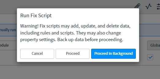

Ok if you are confident that your encoded query is correct then go ahead, do it in lower instance, BTW for fix script just run it for one record pass sys id of RITM and run fix script by clicking on proceed if that works then run it for all and for all click on 'Proceed in Background' so that it will run in background and you can do your work. Also add a count so that you will come to know how many records are updated, please start with one record don't run for all , run for all only when you are sure, lastly when running for all first comment update() operation and check the count and if count is correct then uncomment update() and run in background.
