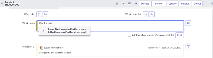

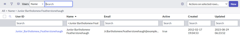

Rahul Patil1
With a larger name/Email id the @mentioned card is truncating information. Any idea how we can customized a card size/width of @mention? Attaching Screenshots for reference.
1. On record form with @mentioned card truncating values.
2. Actual User Information:
Please Advice.
Thanks.
