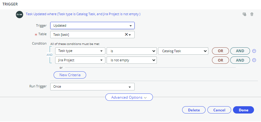

Flow Trigger
  1. The Trigger is then where a Task is updated and:
    1. Task Type = Catalog Task
    2. Jira Project is not empty
    3. Run trigger once
