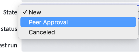

- Navigate to sys_choice table. Modify the label of Assess to Peer Approval.
- Notice that state field choice label has changed to Peer Approval.

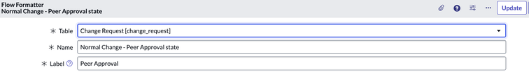

- To modify the state label in flow formatter, navigate to System UI -> Process Flow. Check for the label Assess of change_request table and modify the label to Peer Approval.
- Notify that the state label in flow formatter is updated with the new label.

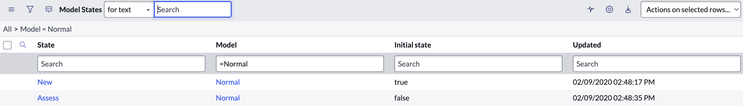

- Navigate to the sttrm_state table and open the record of the state that you want to modify.
- State label field in the Assess record is not editable. To modify this use below script.
