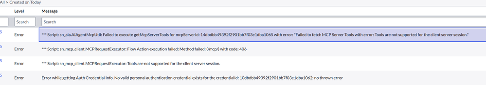

Additional Errors Observed in ServiceNow System Logs:

I think depending on which version of the MCP Client you are running, it's possible that we are only supporting "application/json" as the content type. I do know that we have compatibility (not true support) for "text/event-streaming" in the later MCP Client versions. You should verify that you are running latest.
Everyone's local MCP server has been different so far, and frankly they have not been that easy to debug. I'll try to round a list of requirements from our side.
If it's your own MCP server, you can try relaxing the header requirements so that only "application/json" is required. If you're using FastMCP, I believe it's setting "json_response" to true.
