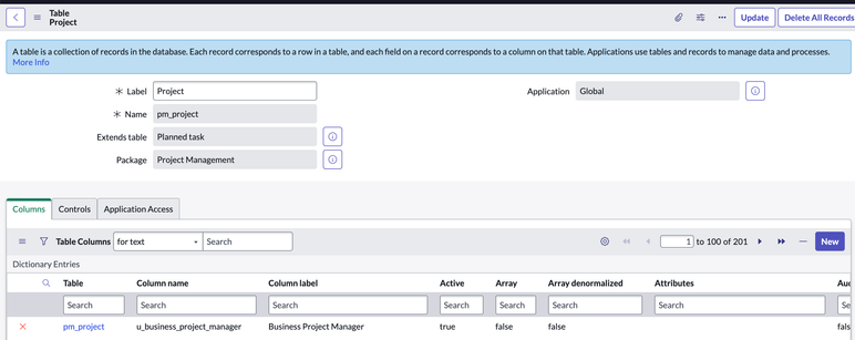

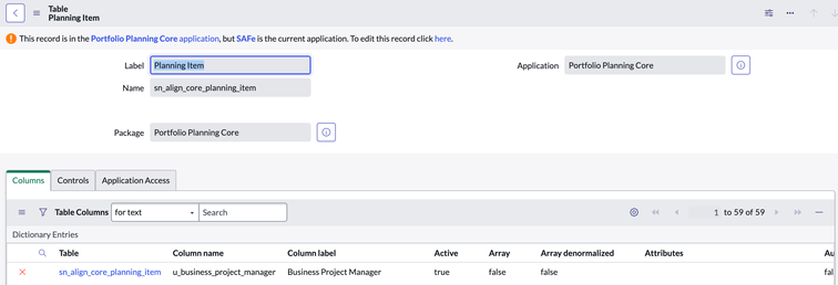

1) Create a custom field in execution as well as planning item table 

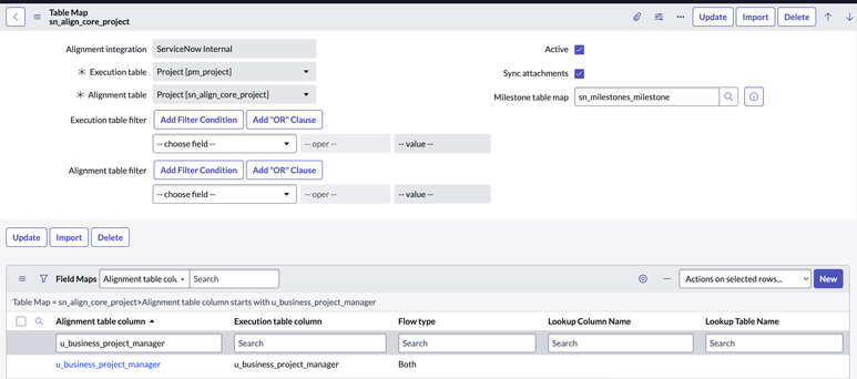

2) Map the custom fields created in execution and planning item tables

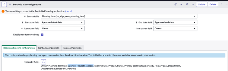

3) Make the custom field available for 'Group By' via 'Portfolio plan configuration'

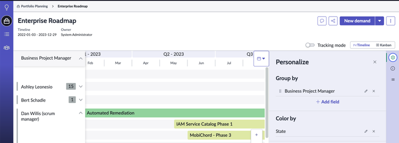

4) Create a free form roadmap and you should be able to group by the above created custom field
