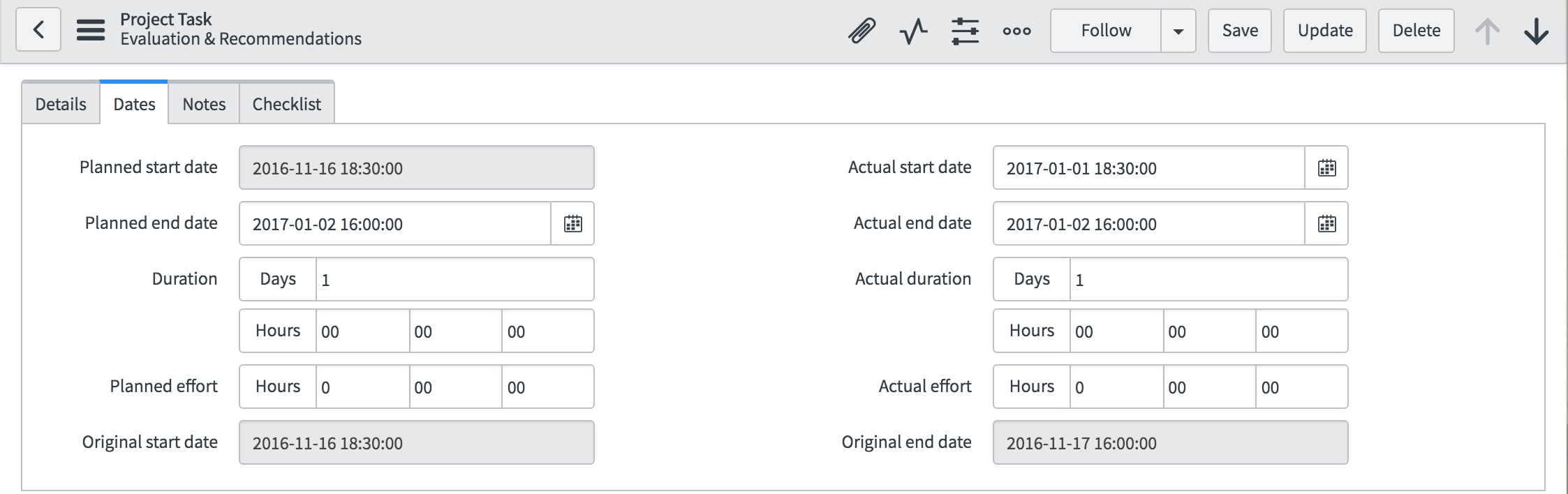

ServiceNow Project -> Date section works in following way.
  • When a Project/ Project task has child Project Tasks - Planned End Date and Duration are calculated fields and MUST remain READONLY
  • When there is no child project task, duration is editable and planned start date, planned end date and duration works in synch to each with help of on-change client script
Hence it is recommended to use system as above.
Please see below examples
Non-Editable duration
editable duration
