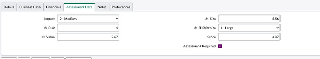

From the screenshot, it looks like you would
1) Send the assessment to all the stakeholders when demand's state = screening
2) Once all the assessments are submitted, the demand moves to qualified state and now you do not want to use the score calculated as a result of the inputs provided by the assessment results.

The requirement is -set as manual the demand score calculation-. I just need that demand managers put their own values in risk/size/value field and then the score demand be calculated automatically.
Currently, the demand managers can't calculate it manually because the demand score value is based on assessment results, so when they put their own risk/size/value values to obtain the demand score, it will be not sufficient because the demand score will change again based on the assessment results when the state changes to qualified or when the demand is updated.

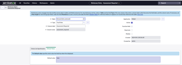

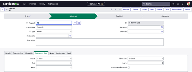

2. Set the "Assessment Required" field as false. This way no assessment will be sent to the stakeholders. Demand manager can set all the values.
In fact you can also remove the screening.
After making "Assessment Required" as false, Screening has no use. Click on Screening would transition to Qualified.
Hope this will resolve the query. If it does please mark the response as correct to help me and other community members.
