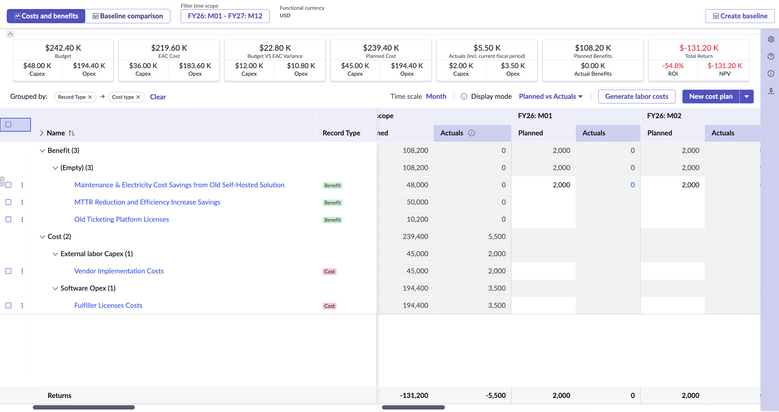

When you create a benefit plan, it creates "breakdown" records (see at the bottom):
On each breakdown, there is the Entered Benefit (planned) and the Actual benefit (actual). If you use the financials page from inside the workspace, these breakdowns are what you see and update on the grid view:

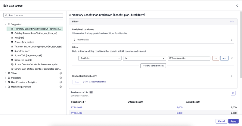

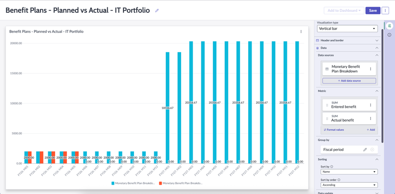

Knowing how that's stored, you can easily create reports on portfolio/program level. The neat thing is that these breakdown records have a portfolio and a program field inherited from the project, so you don't even need to dot-walk for that!
Here's an example bar chart in platform analytics with all the aggregated planned and actual benefits per fiscal period on a specific portfolio:
Of course, if you realize this data model, visualizations and aggregations is the easy part :).
