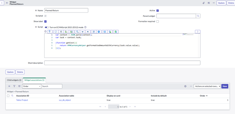

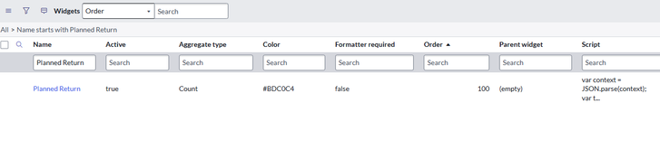

Keisuke Nagata
Hi @Vinay3 , thank you for your response!
I reviewed the documentation, and as shown in the attachment, there was a Planned Return record available OOTB.
(It might be demo data, though.)
How can I display this on the Financials page?
Also, I’m glad to hear that Monetary Benefit Plan will be available OOTB in the near future!
That widget is from the classic financials page widgets. You can make it visible on the new financials by change the widget association to 'Investment' following this docs page: https://www.servicenow.com/docs/bundle/xanadu-it-business-management/page/product/spw-financials/ref...
