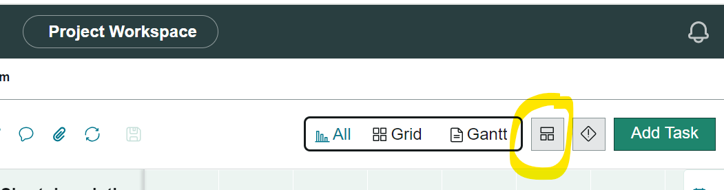

Hi Damian,
Thank you for the detailed guidance. I followed the steps you provided, but it seems the changes didn’t take effect. When I previewed the page before saving, the planning tab was blank and didn’t load any data. I went ahead and saved the record, but there was still no change and the button was still visible. Please see the attached screenshot for reference. Is there any additional configuration I need to perform to get it working? Your advice would be appreciated.
Hello @PatriciaA987250
did you try log out and log back in?
Also try cache.do and even clearing user preferences.
If this does not work, open a case with servicenow, they will provide some guidance.
I know for sure that button will show if you have it_project_manager role and if you don't have that role it will dissapear,maybe there isn ACL that controls this behaviour on the project workspace.
Please keep me posted.
