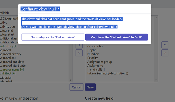

I am facing an issue with the form layout of the child table which inherits demand table where I had tried to delete one column from the table which is created by me but I stopped it in middle since it was taking too long .
After that action whenever I am trying to open form layout this checkbox is showing ,I dont know what should be the appropriate process to do from here to have the form layout like before -
Kindly can someone guide how should I resolve this issue ?

Hi @thirumala2 ,
In the form layout page at the bottom click on Show versions and open an update which was working and then in the related list select a version then right click and select revert this version.
