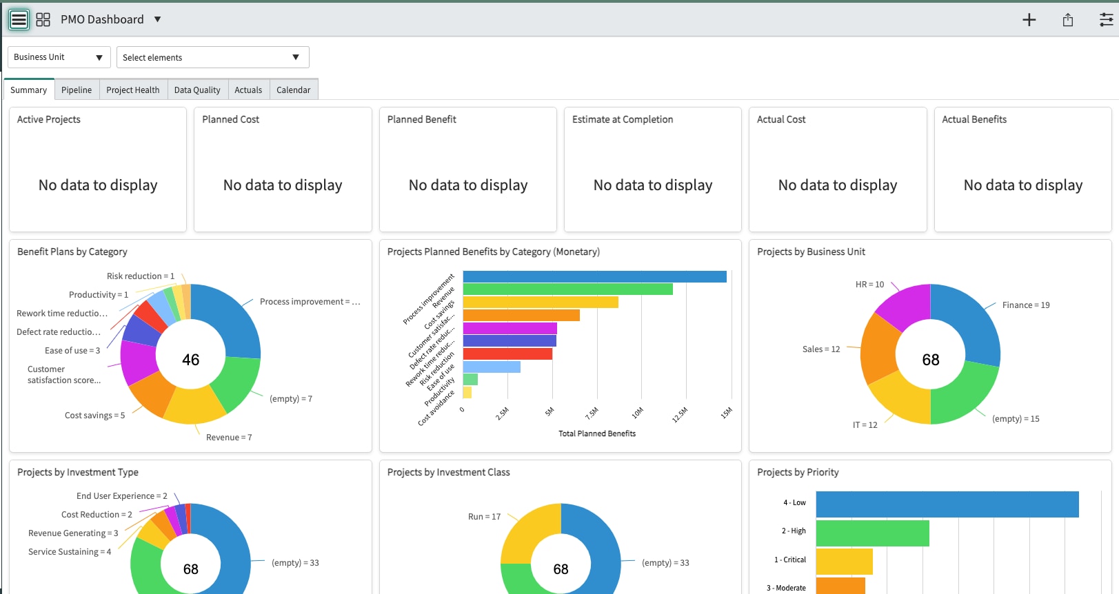

Just all some clarity to the above comment. The Demand report mentioned above is part of the PMO Dashboard, which utilizes ServiceNow Performance Analytics functionality.ServiceNow Performance Analytics is licensable functionality. I would check with your SN account team to make sure you can use it. Usually, most PPM packages come with it.
Once it's active, it will show up in the menu as the Portfolio Dashboard.
find_real_file.pngIf you don't see it on the menu option, you will need to turn on the PMO Dashboard plugin (com.snc.pa.pmo_dashboards plugin).
https://docs.servicenow.com/bundle/quebec-it-business-management/page/use/dashboards/application-con...
Another thing you will need to do is turn on the "metric jobs" to populate data for the reports/dashboard. Here is the post that explains how to do it - https://community.servicenow.com/community?id=community_blog&sys_id=32d5ffdddbfa6c10190b1ea6689619a9.
If you don't run it, you will see a "No data to display" message in the reports.

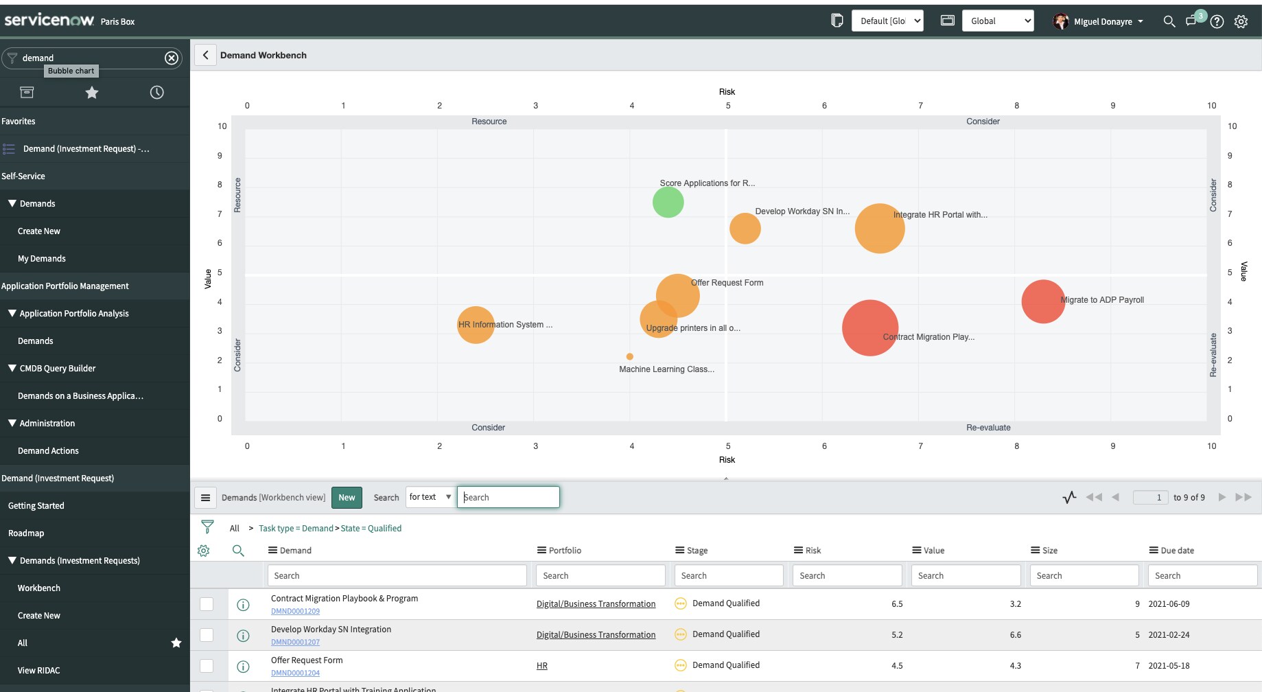

The only other reporting capability that Demand has OOTB without additional functionality is the Demand workbench- https://docs.servicenow.com/bundle/quebec-it-business-management/page/product/planning-and-policy/co...
It is ready to use without any jobs that need to run.
