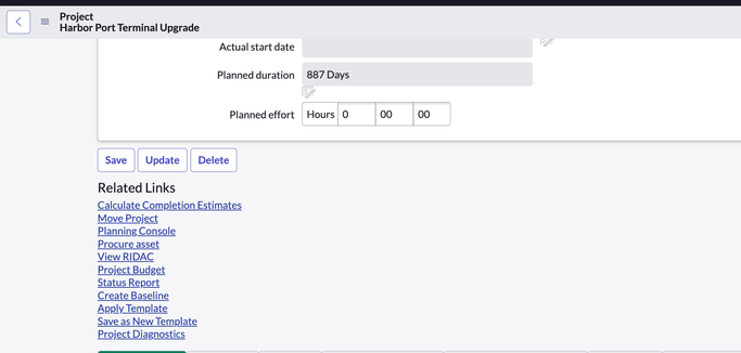

Please guide them to use the UI action - "Save as New Template" to save the project as a template.
Below is the screenshot:
Hope this will solve the issue. If it does, please mark the response as correct answer.

Yea that is exactly what we are using but it is not saving.....   He has the proper it_project_manager role.
