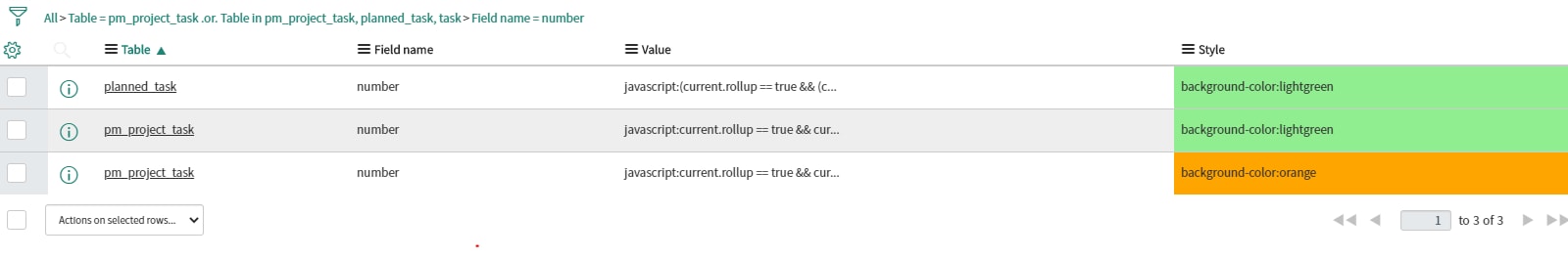

This is a style configured on Number field of Project. it is rolled up from project task and sub projects.
Also good to check is:
https://docs.servicenow.com/bundle/orlando-platform-administration/page/administer/field-administrat...
Thresholds are configured on this percentage fields.

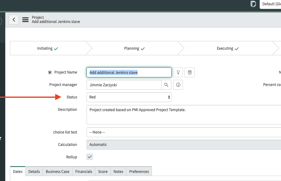

Miguel Donayre

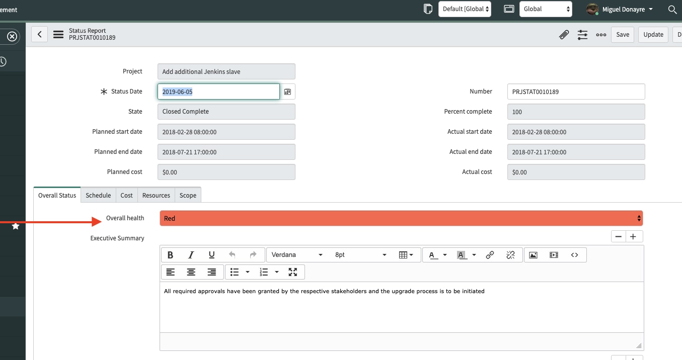

There are no auto calculations it is manually selected. The user can select green, yellow, or red.  SN will populate it from the latest "overall health" from the Project Status report, or the user can set it manually.
project form -
Project Status Report
The actual color is getting pulled from the style records
