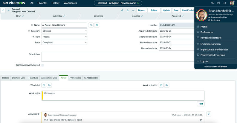

Out of the box, you can post the work notes even after the demand is closed. For your reference, I have added the screenshot to showcase the out of the box behaviour.
