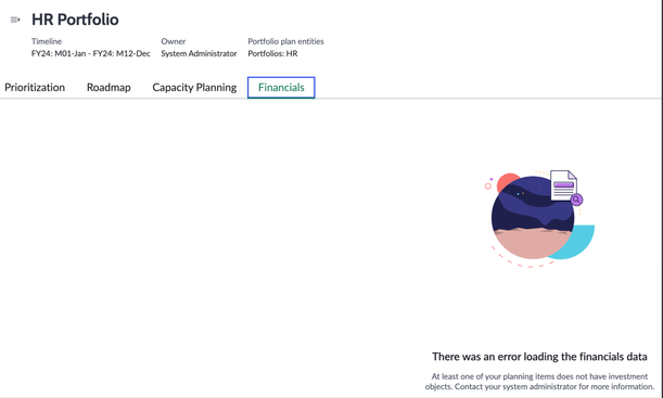

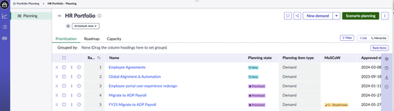

"I am not able to get the Financials section for working lens of Portfolio Planning Workspace to work." - Can you please clarify if
1. you are not getting the Financial section itself (as shown in below screenshot)
2. Financials section is shown but some error is shown and not the actual information such as:
Please share the screenshot that would give an idea of the error that you are facing.
Thank you!
Thank you!
