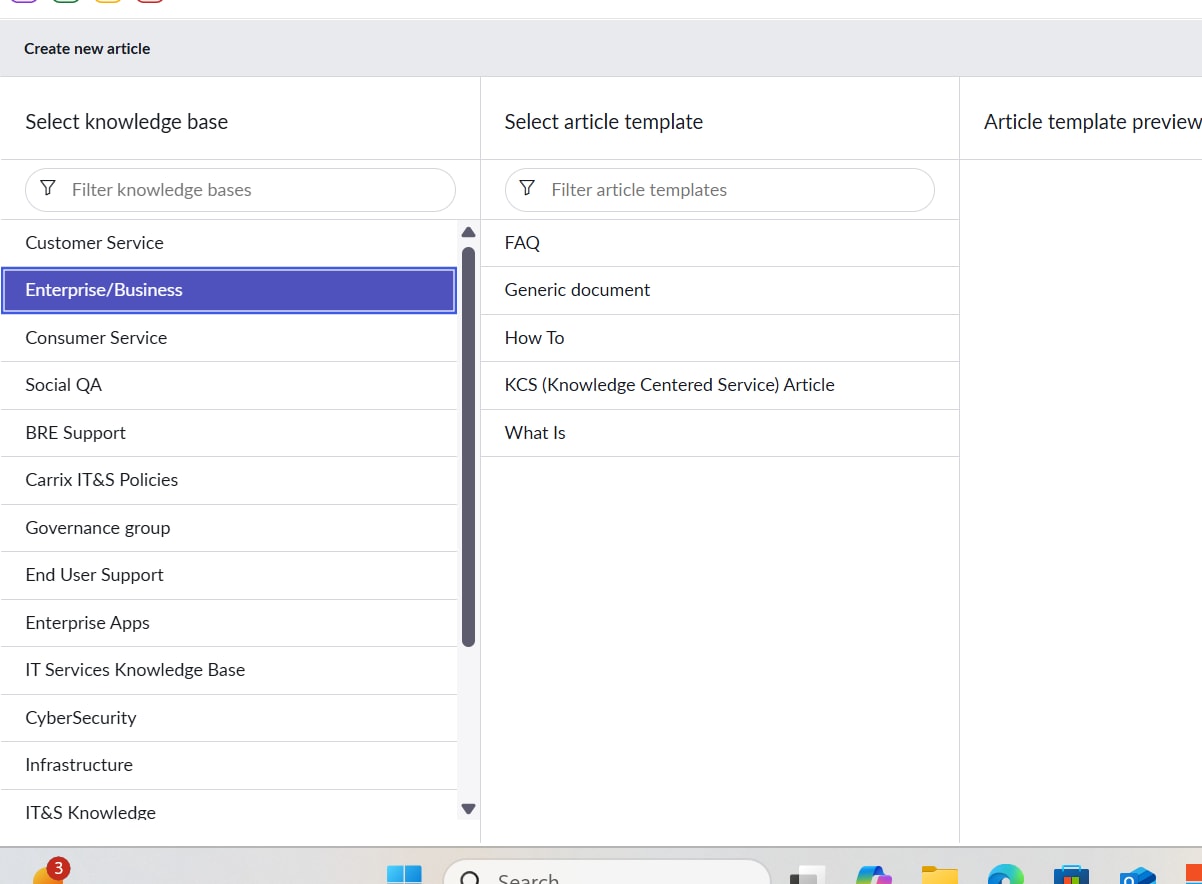

I can see the dictionary entry you're working with. Here's the key clarification — modifying the Attributes on this kb_knowledge.text dictionary entry actually does apply to all articles that use this table directly. The reason you might not be seeing it work for all articles is a different issue entirely.
The likely root cause: child/extended tables
Looking at your first screenshot, you have multiple article templates (FAQ, Generic document, How To, KCS Article, What Is). In ServiceNow, each of these templates typically maps to a child table that extends kb_knowledge, for example:
  • kb_knowledge_how_to
  • kb_knowledge_faq
  • kb_knowledge_kcs
  • etc.
Each child table can have its own dictionary entry for the text field that overrides whatever you set on the parent kb_knowledge.text. So your change on kb_knowledge only applies to articles using templates that don't have their own override.
