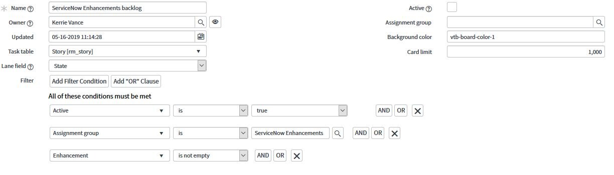

I have created a Virtual Task Board for the Story Table that will show all active records assigned to a specific group were the Enhancement field is empty. (see screenshot below)

Romulo, as long as the new story that you created matches the filter condition for the VTB, it should show up on the board. For example, in the screenshot you have attached, it requires that the stories on the board match three conditions - Active is true (which is the case for all new stories, by default), assignment group is "ServiceNow Enhancements" and Enhancement is not empty (which would be true if the story was created from a related list of an enhancement or if the enhancement on the story was set explicitly). Sometimes, there could be a seconds delay for the VTB to sync up for the new records.
