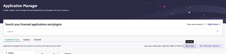

Hello @HS7 ,
This issue is sometimes related to an instance cache problem in the PDI. Even though you're logged in as an administrator and the plugin appears in the list, clicking the Install button might not trigger any action due to stale cache. Clearing with "cache.do" helps. OR
You can try requesting plugin through the classic App manager :
Also get the option of repair the plugin if installed.
