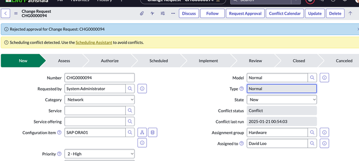

I have a Xanadu instance. I have read the release notes and followed what I believe is written here.. I had started an normal change, rejected it as an admin through a CAB Approver and the state is reverted to new, but am still unable to change the type.. I have checked my ACLs and do not see the new access control change_request.type .

03-07-2025 04:25 PM
I believe this is the expected behavior now. I’m currently in Yokohama and tested your use case, but I was surprised to see that the change type is non-editable. This means we need to cancel the current change and submit a new one.
