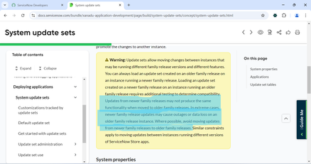

AnushaB
Hi @j0e matts,
Please refer to documentation https://docs.servicenow.com/bundle/xanadu-application-development/page/build/system-update-sets/conc...
Anusha Bonthu

AnushaB
Hi @j0e matts,
Anusha Bonthu
