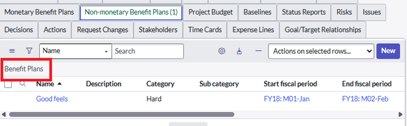

In the case of direct references, or reference to extended_from table, the related list will have a visible condition. Take the Project Tasks tab.
In the case of custom relationships, the related list won't show a filter, but rather just a table name. Take the Non-Monetary Benefits tab for example.
