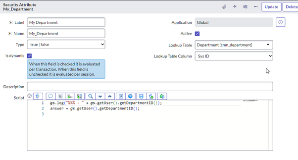

I am trying to create some customized Security Attributes with Data filtration, but it doesn't work.
My objective is simple: Give access to Incidents assigned to the group "Network" only for user with the department "Sales".
Then I have created the following Security attribute:
*I also have tried using string type.

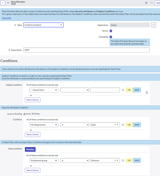

I also have created the following Data Filtration:
But it doesn't work.
with that gs.log I can see that the script is executed, but the data filtration cannot deal with the security attribute.
Does anyone know what could be wrong?
