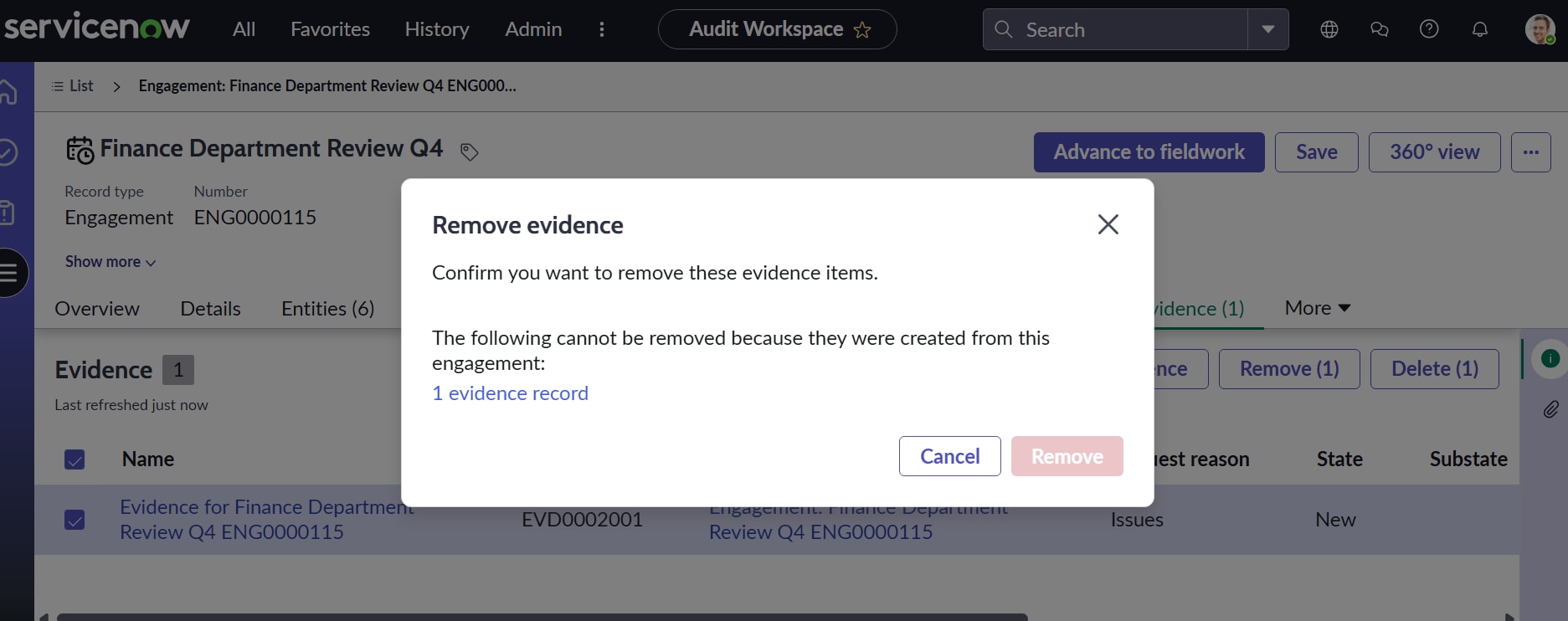

In recent days, I am unable to remove the evidence record from the engagement (In audit workspace). When I try that in developer instance its reflects the same. Anyone help to fix this / Tell the core which make this change.
Its showing the pop up to remove, but remove button went disabled.

I can remove the evidence in my PDI:
This is because if you are creating a Evidence from the current engagement record using "New" button, you cannot remove the same.
However, if you are using "Add Exixting Evidence" , then you can remove the evidence.
