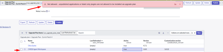

From what I understand, I have to set Active to "false" in the Upgrade Plan Item list, but half of my apps refuse this update and show the error "Not allowed - unpublished applications or Maint only plugins are not allowed to be installed via upgrade plan" which seems counter-intuitive, since I am trying to remove the item from the plan, not to install it.
Here is an example after I tried to set "CMDB Agent Workspace" to false.
This means I am unable to remove items from the Plan.
