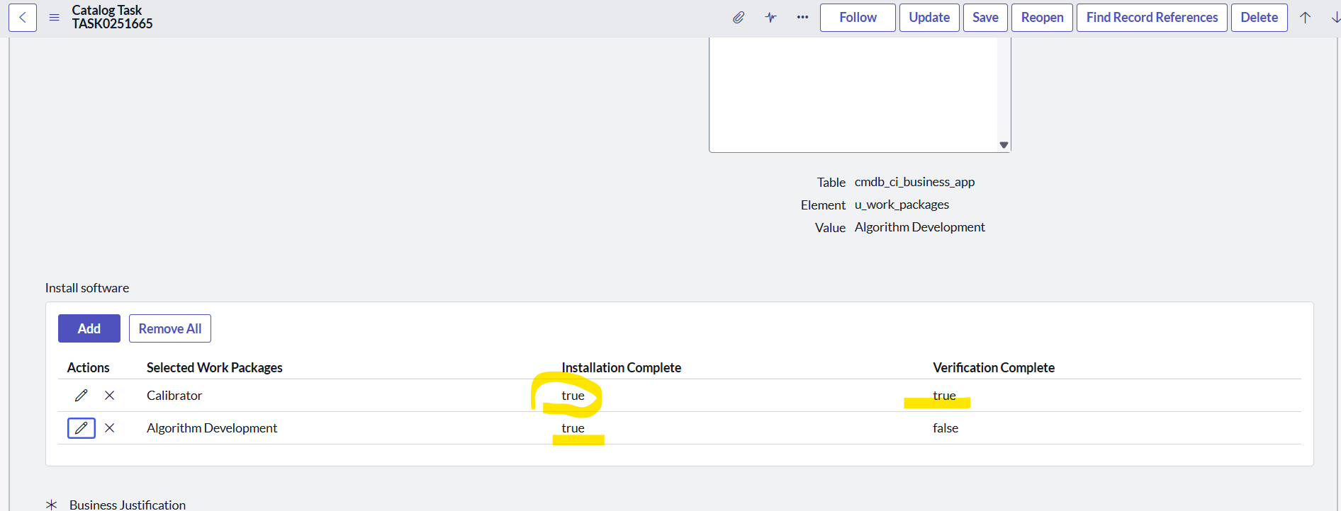

Hi Team,
anyone know how to solve this problem I have multi row variable set with 3 fields in this 2 fields are check box type default displaying 'false' Task2 added this Multi row variable and come to catalog task i have modified the check box values and task closed after open the task2 its not stored changed check box values. for this i tried Business rule but its not working for more details find the screenshot if you know solution please guide me.
Thank you
PB

I'm not following, especially when looking at the screenshot which shows 'true' values. You don't want or need a Business Rule to update a variable value. Wherever you update a variable - whether it's inside a multi-row variable set, single row variable set, or neither - on a request form, RITM, or Catalog Task, the same value will show on the other forms. If you are not seeing the boxes checked when you edit a row again, ensure you do not have any Catalog Client Scripts or Catalog UI Policies that are affecting these variable values.

Step 6: <Problem in this step>
sc_task 2 displayed with catalog form whatever submitted for example
List collator type field value --- CAD
multi row variable text field .... CAD , Check box 1 - false , check box 2 - false (This check box default values only showing 'False')
Now I am Edited row for check box 1 changed to True , Check box 2 - also changed to True then saved in Multi row
Same Task 2 - state changed to Closed complete , mandatory fields filled and Updated the form .
again opened Task 2 and seen multi row variables this check box showing default values like False instead of True.
@Brad Bowman same time other catalog form variables also modified in sc_task which are single row variables along with multi row thos are normally updated with new changes except multi row variables. I have tried multiple ways i have seen sc_multi_row_question_answer this table also values are saved with parent table RITM number .

10-26-2025 10:32 AM
