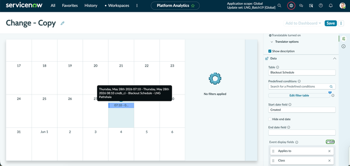

Dr Atul - LNG
Hi @dwerner
I created a report for the same and I’m able to see my blackout schedule.
You cannot add two tables in a single report/query at the same time.
