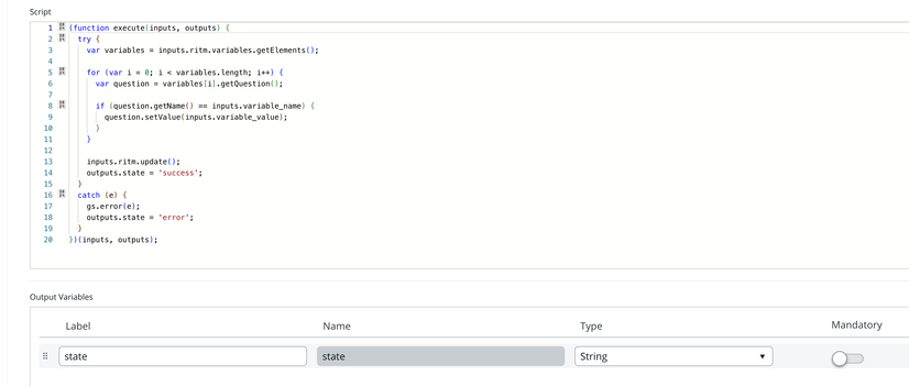

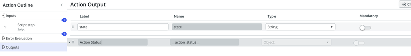

As there is not a 'Script step' on Flow Designer Flows or Subflows, I assume you're referring to an Action.  If you are using outputs.name in a script step within a custom Action, you need to also define an Output Variable with that same name and the appropriate type

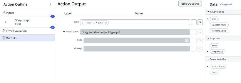

If you want to view this value in the Flow or Subflow which called the Action, you must also create an Action
Output
then assign a value to the Action Output (using the data pill from the Script step Output variable

Hi @cs2022diatm ,
Make sure there are no errors in your script by testing it in a Background Script or by adding logs at appropriate places.
Follow these steps in your Flow Action:
  1. In the Script step, ensure the output variable is created in the Outputs section with the correct type.
  2. Assign the value directly to the outputs object, for example: outputs.result = 'XXXXX';
  3. In the Action Output step, create an output variable and map the result from the Script step by dragging and dropping the corresponding data pill from the right-hand pane.
 Remember to remove any logs once the issue is resolved.
