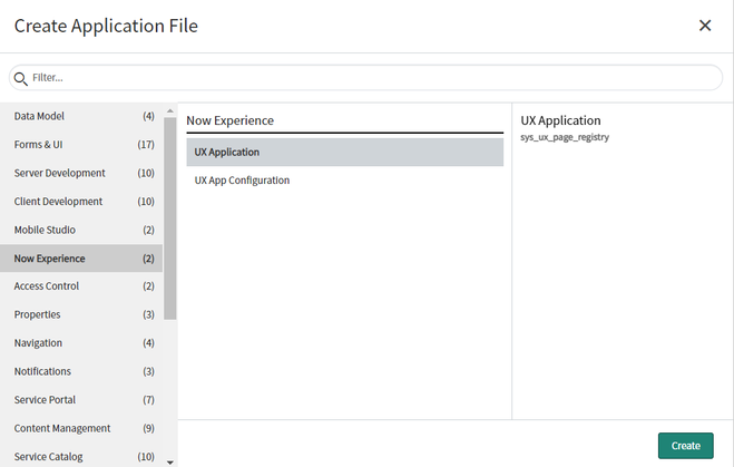

We currently do not have the App Engine Studio and when creating a new application from Studio, I do not have the option to select workspace which I believe we had previously. I only get the following options. I already have the Scoped app created and am needing to create a workspace experience with it.

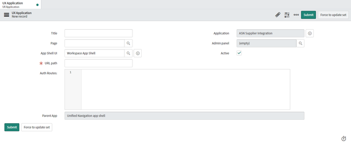

You can create a workspace from studio as well, simply add a new application file for UX Application
Select "Workspace App Shell" as the app shell ui

This isn't entirely accurate. If you have to create a net new workspace it's definitely easiest to do with AES, but it is possible to create a new workspace from scratch with Studio and UI Builder itself. I'd recommend referencing an existing workspace as well as there will be a bit of manual work involved.
We definitely recommend starting with one of 50+ workspaces we're shipping by default, and if you can't do that to use AES, but if you're not licensed for AES you can create one from scratch.
This is a helpful resource: https://www.youtube.com/watch?v=UIpIx6n_uyg

you only can create Workspaces with App Engine Studio (AES). That's the situation. Don't ask for alternatives.

Check out Brad's post Maik, he has the right answer.
