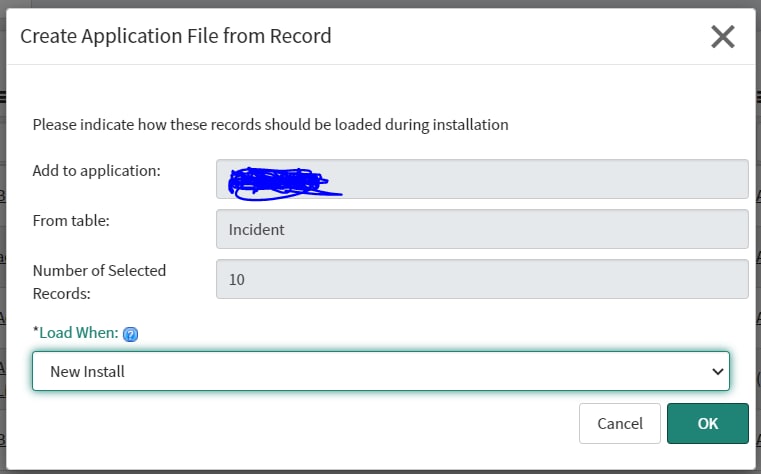

Deletion results in missing application files under application (Not recommended).
Mark same data as below to load on new install so it does not affect the data changes during upgrade.

  • Navigate to https://*.service-now.com/sys_metadata_link_list.do
  • Search data /table in payload contains Search
  • Delete the entrees
