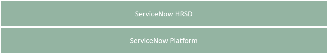

What I understood so far is that ServiceNow (or the "ServiceNow Platform") comes with a global scope. This scope contains “older” applications such as ITSM. Application scoping was introduced meanwhile for several reasons such as data segregation, development and deployment purposes. New modules, such as HRSD and CSM base on the ServiceNow platform:
Let me now try to introduce you to a simple and exemplary setup that I want to use to address my questions:
The international Company “ABC” has decided to use ServiceNow and the HRSD module. There is no other use case than HRSD so far and only subsidiary “Sub1” will use the tool for now. Nevertheless, it might very well be that further subsidiaries will also stick to ServiceNow HRSD in future. An important note is that the particular module (in this case HRSD) takes precedence above the subsidiary.
Following this simple setup, I would want to create an HRSD application just for Sub1. Other tools allow to introduce multiple "application layers" which can base on (one or many) other application (layers). The idea of this approach is to facilitate encapsulation of customizations and it also strengthens reusability. It leads to the following requirements (at maximum extension):
  • Customization and grouping of common Platform assets (applicable for the entire ABC corp.) should be possible (lower red rectangle in the below illustration).
  • Customization and grouping of common Platform assets (applicable only for Sub1) should be possible (lower blue rectangle in the below illustration).
  • ServiceNow HRSD layer extends (enhanced) Platform assets (upper green rectangle)
  • Customization and grouping of HRSD assets (applicable for the entire ABC corp.) should be possible (upper red rectangle in the below illustration).
  • Customization and grouping of HRSD assets (applicable for Sub1) should be possible (upper blue rectangle in the below illustration).
The grey rectangles indicate what might happen in case a second subsidiary would be enabled to use the tool at a later state. Their customizations were separated from all Sub1 specific assets which might be a pro regarding potential risks and divergent release cycles.

Michael Fry1
You should take a look at Domain Separation. https://docs.servicenow.com/bundle/newyork-platform-administration/page/administer/company-and-domai...
Having multiples of the same application doesn't make sense. With domain sep you have 1 application and each sub can have it's own domain. You can apply 'global' customization's to each sub and override customization's to each domain. The data will be separated so each sub will only see their data but globally all data will be accessible and thus reportable.
Personal experience - plan carefully because domain sep makes your life 10x harder than a normal single tenant instance. Obviously with great planning it will work very smoothly.
briandunbar
Hello Stefan,
As Michael mentioned, Domain Sep is an approach that will do some/most of what you are trying to do.  There are a few other options to accomplish multi-tenancy like you have laid out it would take some time for me to lay them all out here but I'd be happy to chat with you through the options.  They all have trade-off in cost, technical debt and fit for use so that's why i'ts not some straight forward response.
At a high level they are:
Domain Sep - SN supported plugin for multi-tenancy - comes with cost
Conditional approach - use ACLs, View rules, Query Rules....- cheap but doesn't scale well
Scoped App approach - App scoping and table extension to create child apps - has some caveats as it can't do complete "app cloning" in all cases.
Multi-Prod - user separate instances of SN and ebond data as needed. - expensive...
Ed Klebanov
Here's another resource re: Domain Separation that summarizes some of the points made above: https://www.servicenow.com/content/dam/servicenow-assets/public/en-us/doc-type/bp/domain-separation-...
Stig Brandt1
Giga Expert
This is a pure Domain separation play imo, as it supports exactly the architecture you are looking for, and yes, it requires more maintenance/developing effort, and also not all modules/functionalities are domain separation supported.
Ex. HRSD is data only supported.
